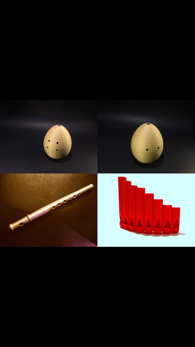

Yes ,actually we are also authorized re seller of Zmorph in Greece , yes is a very good machine and with open software , voxelizer give you the freedom to experiment with a lot of different materials, the good for me is that is a workhorse we use it everyday with no problems and is very easy to service it cause of the open design of it
you can check as here for samples and videos Idea 3D
p.s we have here almost all the heads and the big table (you will find it useful specially when you using the laser or the dremel head

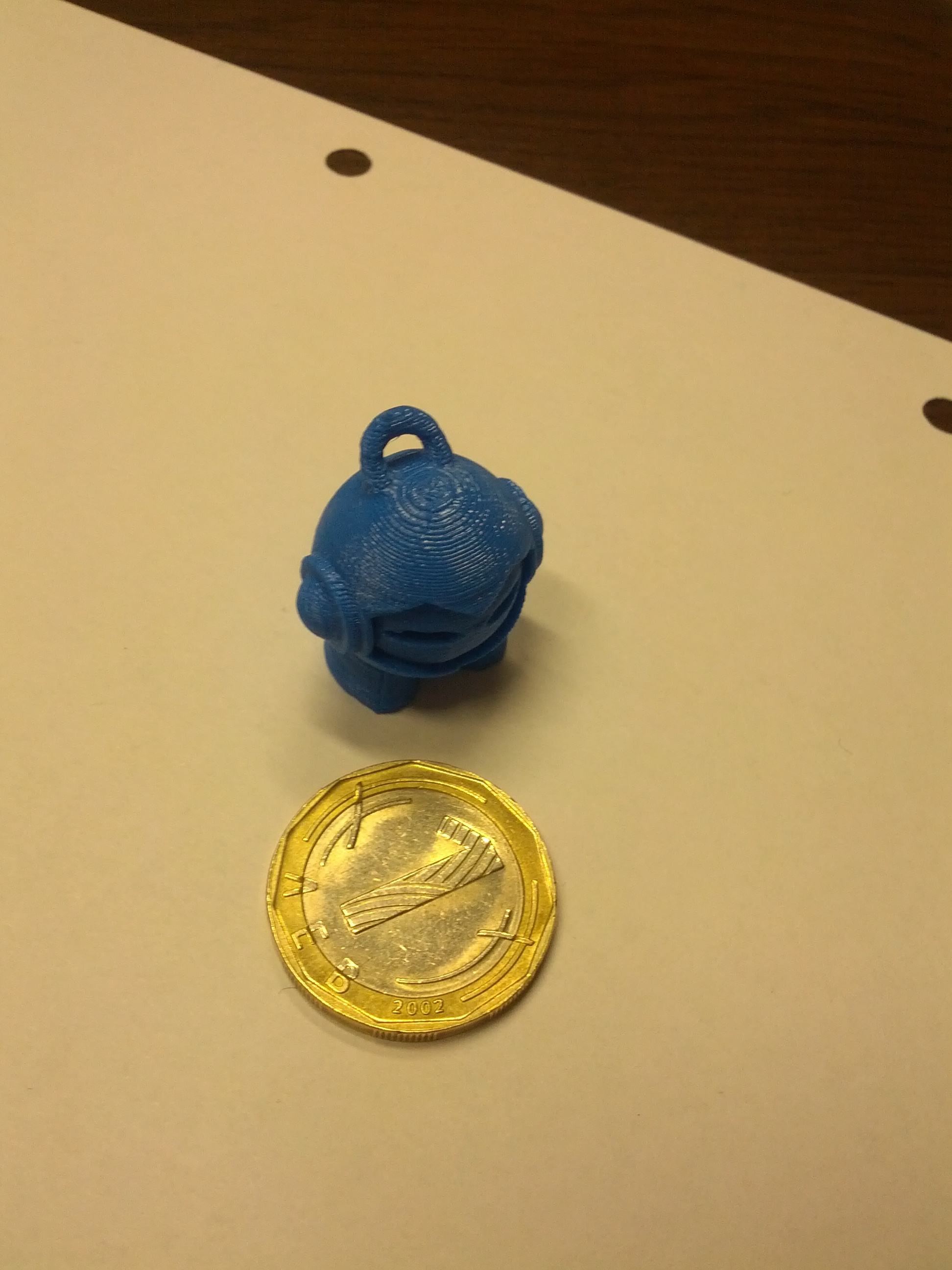

Here is the Marvin that I printed on ZMorph printer. Tell me what’s wrong with this printer again?

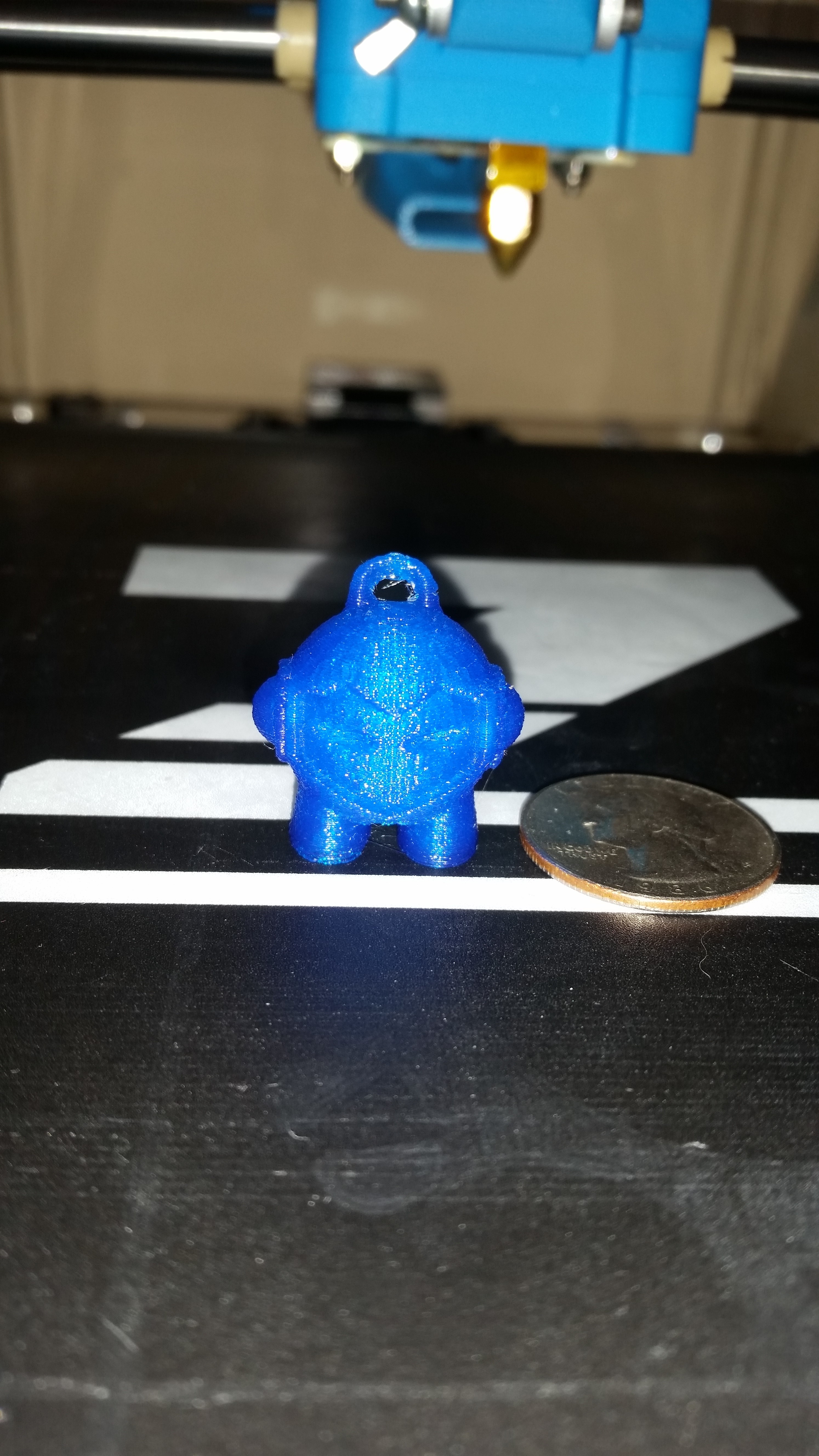

Don’t tell me you think this is a good printing…
Compare it to this one:
Jory
16
+1 - The Zortrax has better print quality than any desktop printer I found under $5k that was willing to send samples. Only downside I see to them is build size and proprietary material options (unless you want to void the warranty).
