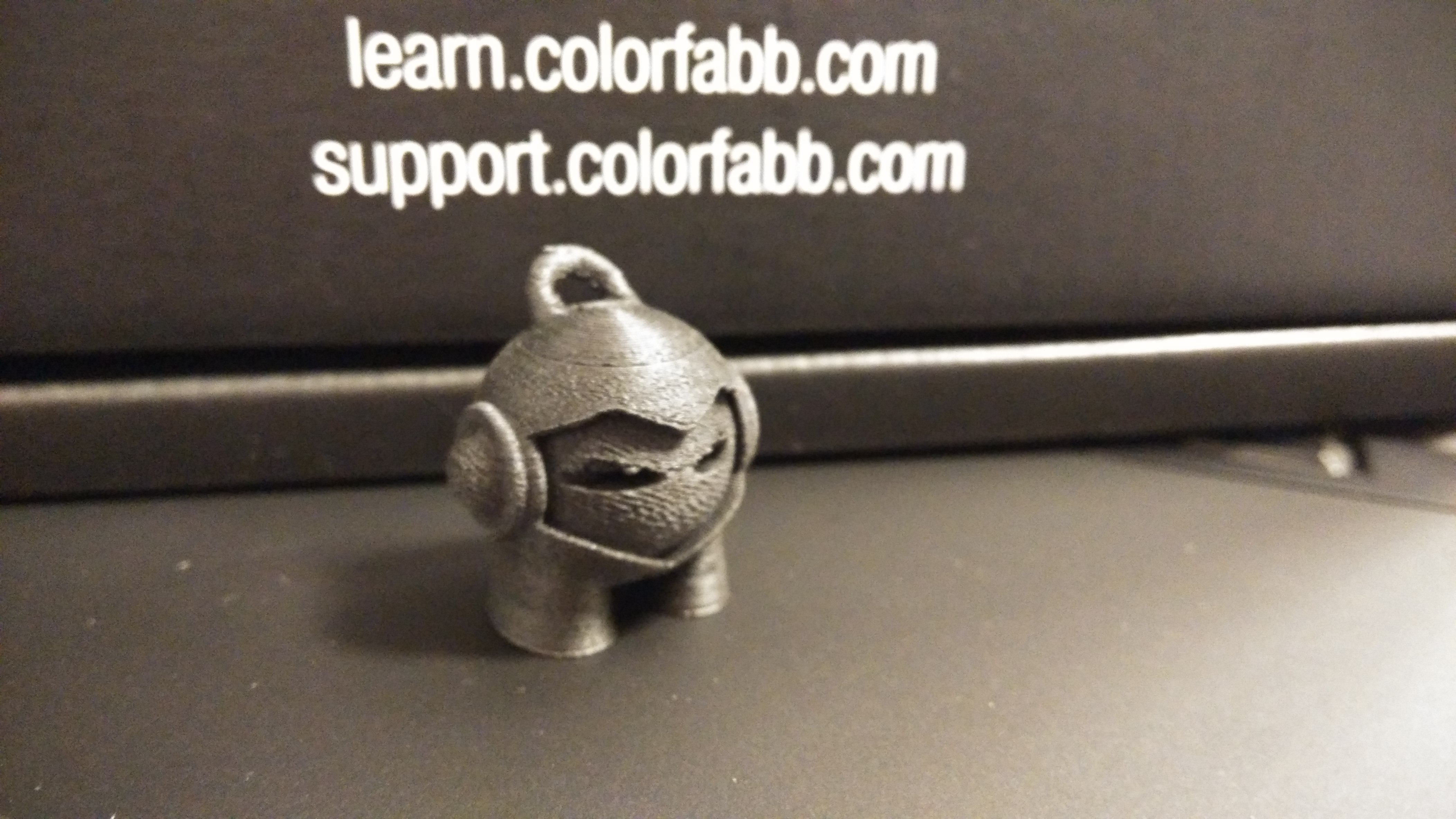

…Hephestos prints with the material you want!!!. Carbonfiber Marvin.
Wow, you pretty much nailed your carbon fiber Marvin! How did you like printing with this particular filament?
Nice to see more people using carbon fibre! @gabriela3d, I absolutely love the XT-CF20 stuff, it has really low warping and the satin black finish is absolutely magnificent.
I can see I stroke a chord there, in a positive way of course, so I’m happy to hear it
What are you printing with it?

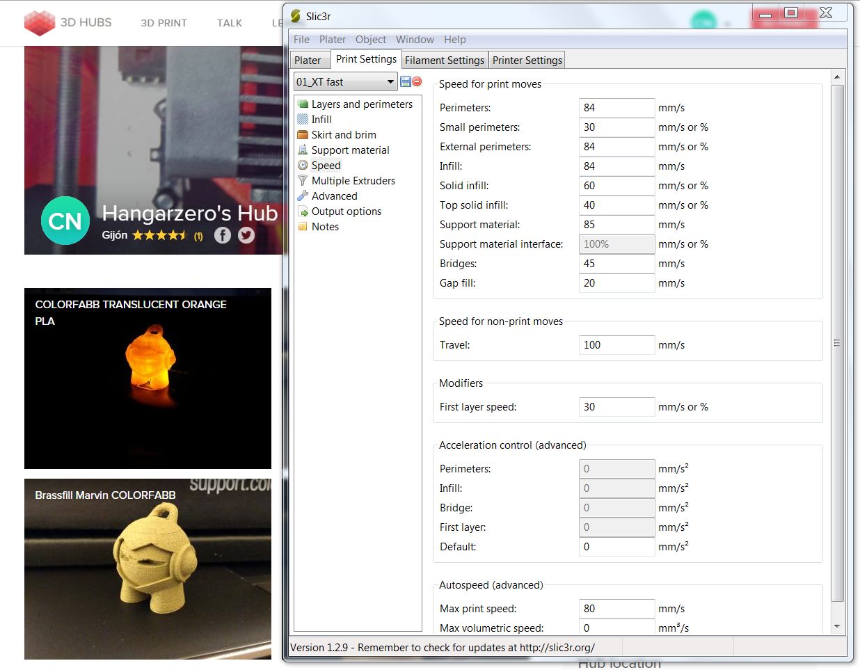

certainly, I only put the filament on top…charge the g code that always used to print with PLA…and increase the temp to the limit of my Hephestos…240C…so easy. Tomorrow I will share the Slic3r parameters.

Slic3R parameters for my Hephestos.
