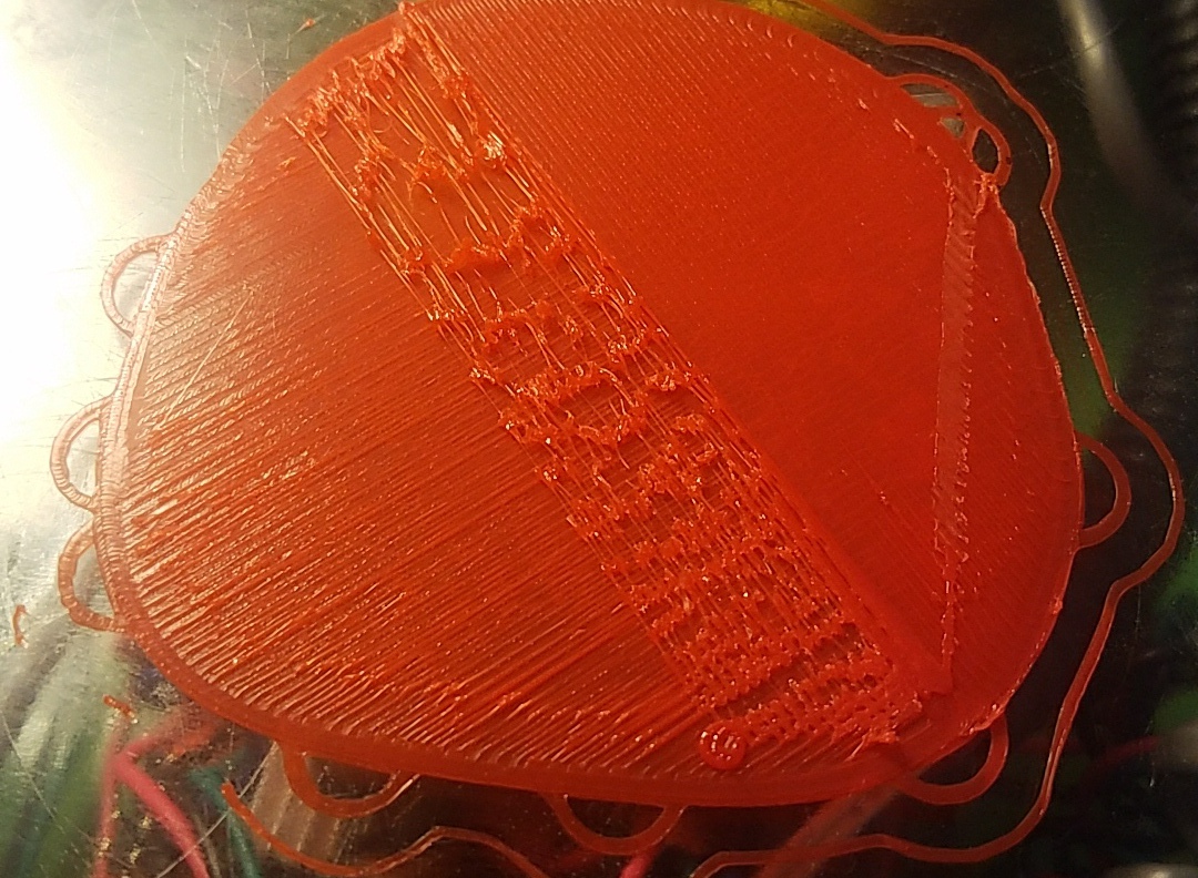

Why is this happening when i print? thanks!
First thought is under extrusion but you will need to give more details. Printer, slicer, material, temps, speeds etc.
From the picture alone it looks like mayor under extrusion. Maybe the wrong nozzle size selected? Give us some more information about the mode/designl, printer, slicer and basic settings.
You were correct! I changed extrusion and that seemed to fix. Thank you.
