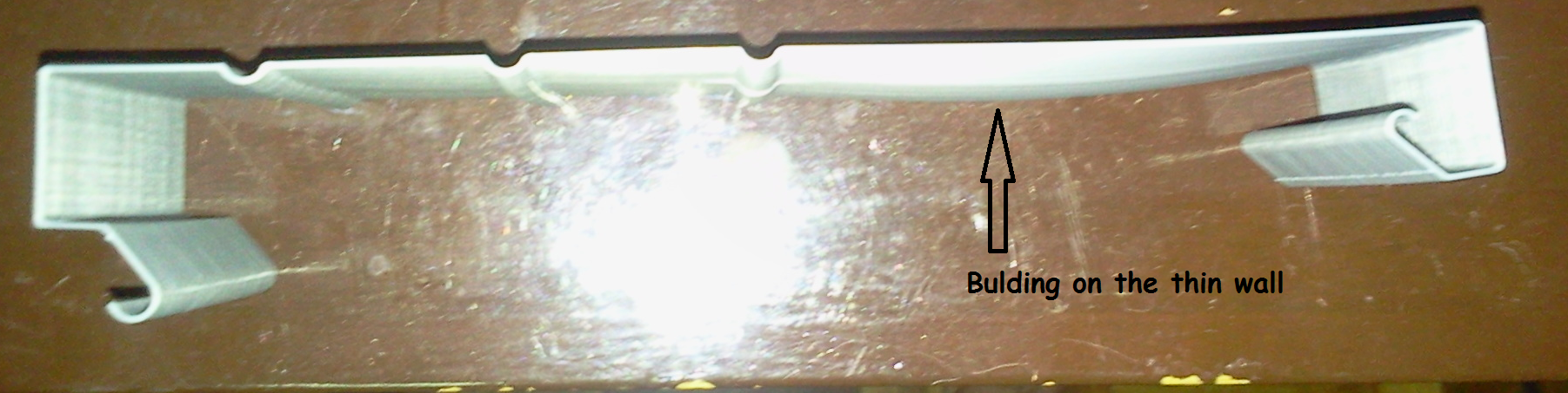

I am trying to print this thin wall object vertically from print bed. As you can see from the image it has a bulging part. This happens halfway midprint. My settings are as follows. By the way I do not have any first layer warping issues with this one, only problem is the bulging or bowing part.
Material : ESUN ABS+
Extruder Temp : 225C
HBP Temp : 110C
Speed : 60 mms
Tried Turning on a fan in front of it, and it just cracked. So I need your help guys, please. Thanks is advance.

Yes I do have an enclosure, but I opened the enclosure as soon as I saw that bowing effect, thinking that my chamber was too hot. It is a very thin walled object, actually two peremiters thick only, and without infill. Do you think I should go hotter on my extruder temp or cooler? Thanks for your response by the way.
I print at 110C because I am using glass with FFCP blue sticker, but do you think I should go lower on my heatbed? Do you think the heatbed is causing the material to bow like that? I really hope you can help me out on this. Thanks.

I suspect that those 3 grooves are your issue, As the part cools, those grooves widen out and push out on the wall. Try adding a few more grooves where the bow is, Thus the part is even down the entire length.
If more groves are not an option… Add small beams across the grooves and cut them out when done. The small beams will keep the grooves from expanding/shrinking.

I never thought of that analysis, regarding the grooves. I could not add or remove the grooves since it is a design from a client of mine. I’ll try that beam method, but can you show me an image example maybe on how it would look with beams. Thank you very much by the way.

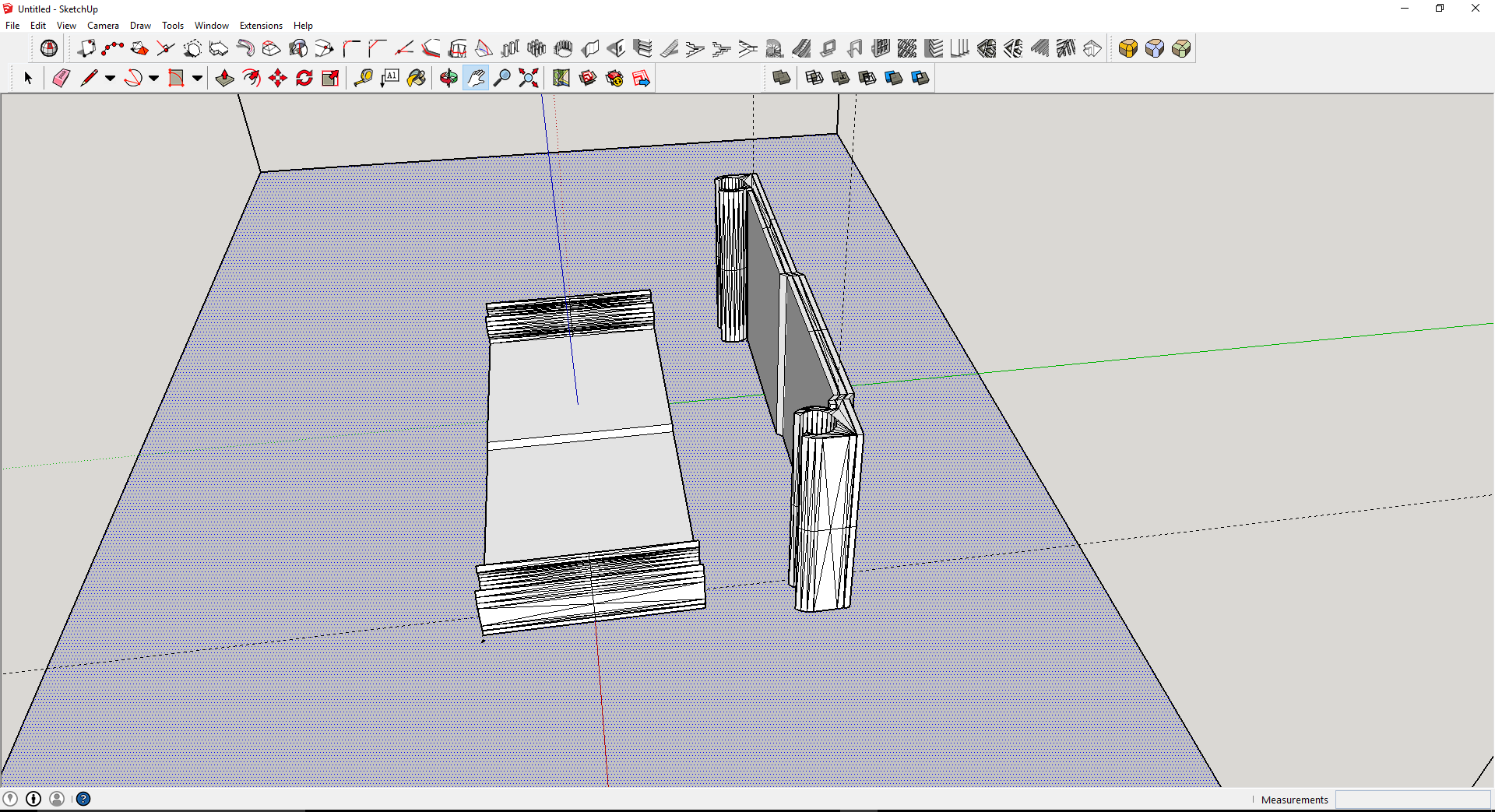

The method I use is very simple, just add thickness to the piece by copying and extruding extra walls. In the picture I choose to print flat because heat dissipation through the print is not bad at all and this method inherently avoids warping (at least it works for me). However, if you have no choice but to print vertically, simply add some extra to the center without connecting. I have a 0.1mm gap between my piece and the added support walls, they sometimes stick together but break away easily at the end. Hope that helps.

Just a quick and dirty example.
Thank you very much for showing me an image, a photo is really worth a thousand words. If it works then, you have saved me from a lot of headache, if it doesn’t then It is better to have tried to learn than not tried at all. Thank you once again.
I’ll see if I can implement this as well, Just don’t know how to remove them supports after. Are those supports really sticking to the design itself? Thanks for the image.

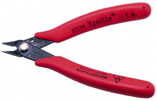

Its a rough sketch… Make them as wide as your nozzle diameter, and line them up so they are easy to cut with a razor blade. Since it a relatively straight edge, It should be easy to cut… I prefer flush cut PCB pliers over a razor blade.
Oh and… measure your grooves at the top, middle and bottom to confirm if that is the issue.
