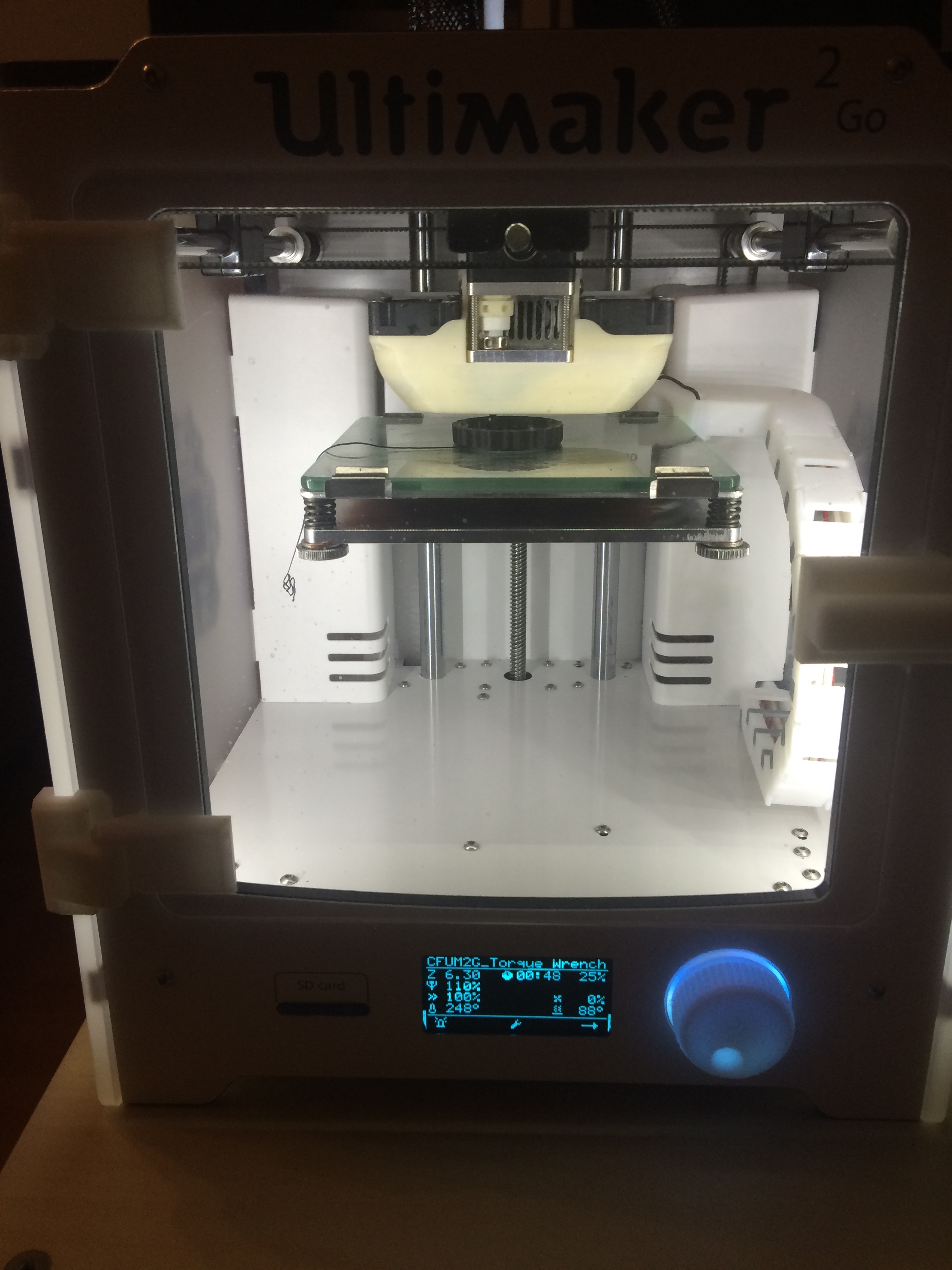

Edit: Here are some pictures of the UM2Go printing Colorfabb XT-CF20 after upgrading to the Olson Block with a 0.5 mm hardened steel nozzle with heated build plate and 40W nozzle heater. Tinkergnome’s firmware which runs the heated bed is not a compromise but actually an upgrade. Highly recommended.
UM2Go settings for Colorfabb XT-CF20:
- 249 degrees 0.5 mm steel nozzle
- 0.2 mm layer height! 0.1 mm might cause back pressure causing under-extrusion
- 90 bed (actual temp around 70, perhaps can calibrate in Firmware?)
- Flowrate 110%
- Fan OFF!
- Retraction 2mm
- Speed 20-40mm/min
