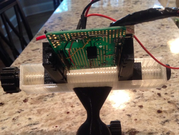

here is a pcbs vise i printed a while back that uses a gear like the one that you are looking to get done. it works flawlessly and was printed vertically as one piece…
A quick glance at the model would make me wonder if there was any way to make the threads a bit shallower as that may aid in the print not needing support if printed vertically.
The wheel however will require quite a bit of support in order to print as designed with FDM. you may want to find a good SLS printer for thesauri at the very least someone that can print in resin with a DLP printer.
