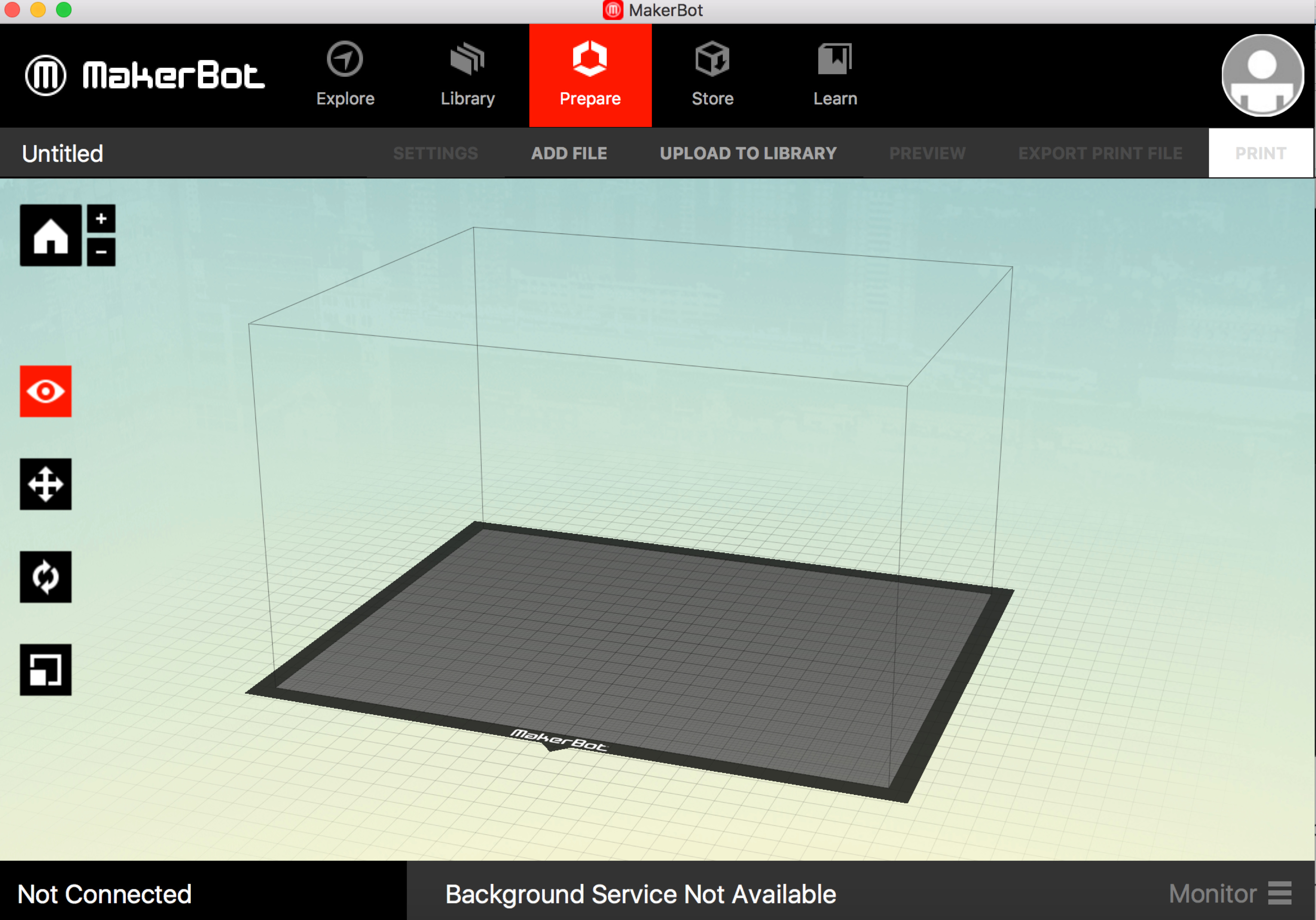

I recently upgraded my MAC computer to Mac OS Sierra and with it I got problems with my makerbot software. I recieve this text when I open the program “Not connected. Background Service Not Available”.
With this problem I cannot change my print settings, cannot export the file to x3g etc.
I can add files as you can see but that is about it.

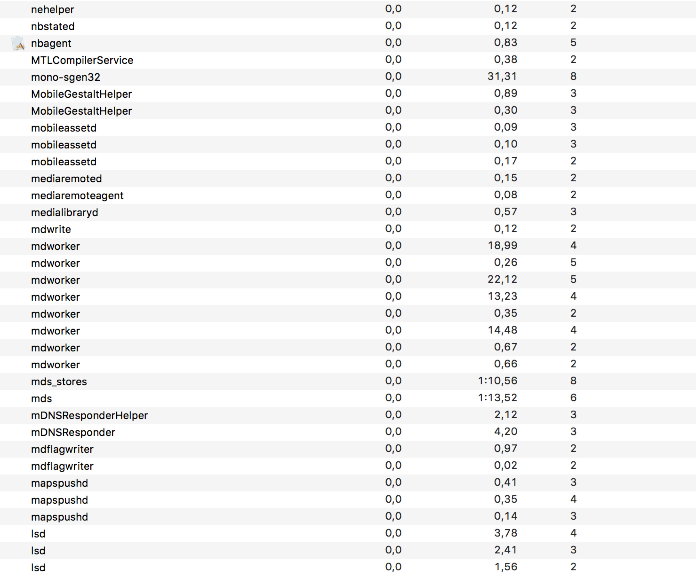

“Activity Monitor” is located in /Applications/Utilities and will display all processes, make sure Makerbot service is there.
I cant seem to find Makerbot service inside the acitvity monitor. I will attach an image how it looks
UPDATE: Okay, now I can see it when I had the program opened. So updating the Nvidia driver might be the solution then maybe? I didnt even know mac had Nvidia to be honest with you! haha

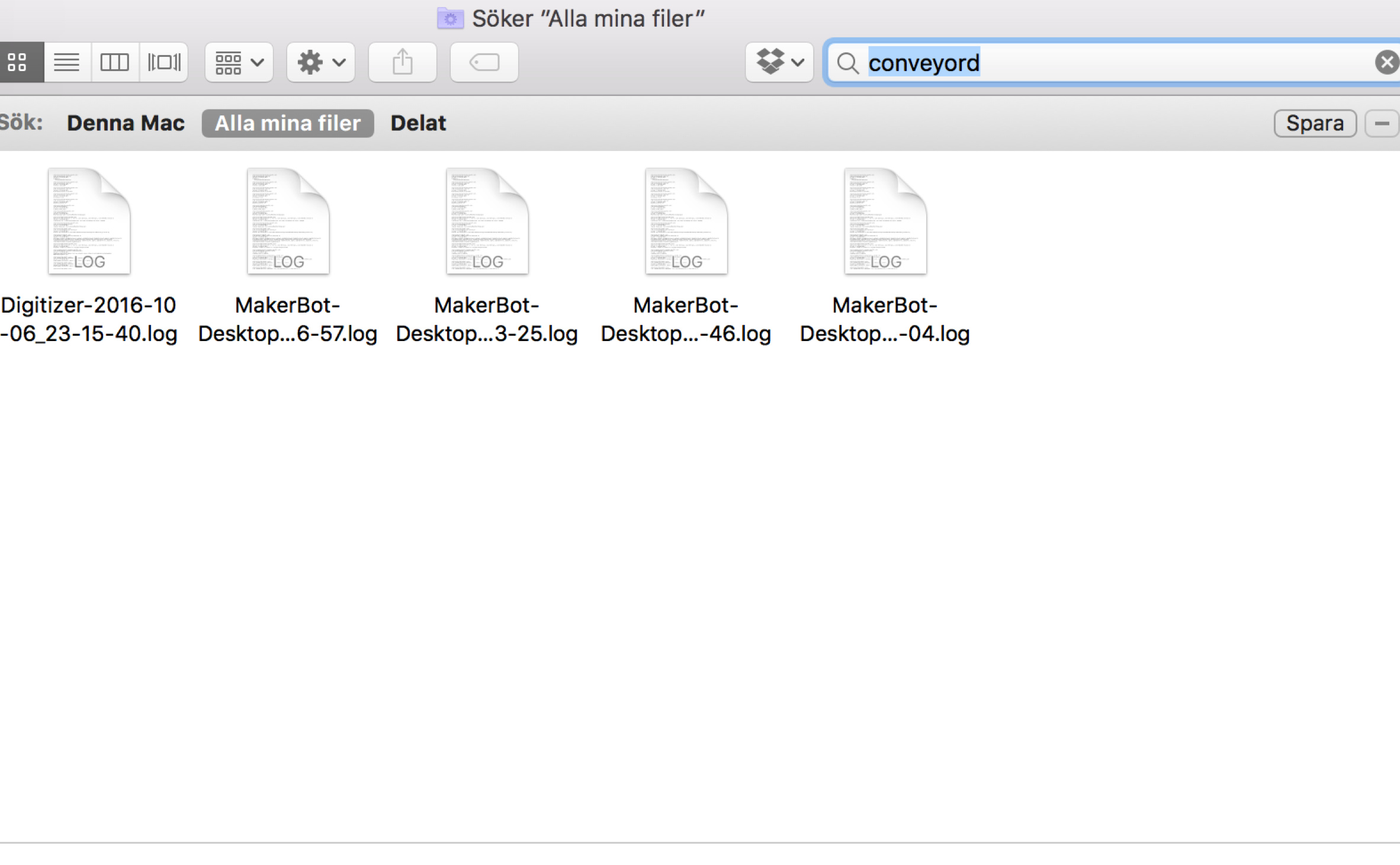

Can you open background service log in the software? (conveyord.log)
Hmm , i doont know quite what you mean. is that a file in the makerbot map?
When you open Makerbot Desktop go to Services->Show Background Service Log
or search for conveyord in All My Files
When I search for it these show:
Check the dates, Right click on the latest one and open it with Console. On the left side menu go to User Diagnostic Reports. Do you see any Crashed Threads? with exception like EXC_BAD_ACCESS (SIGSEGV)
