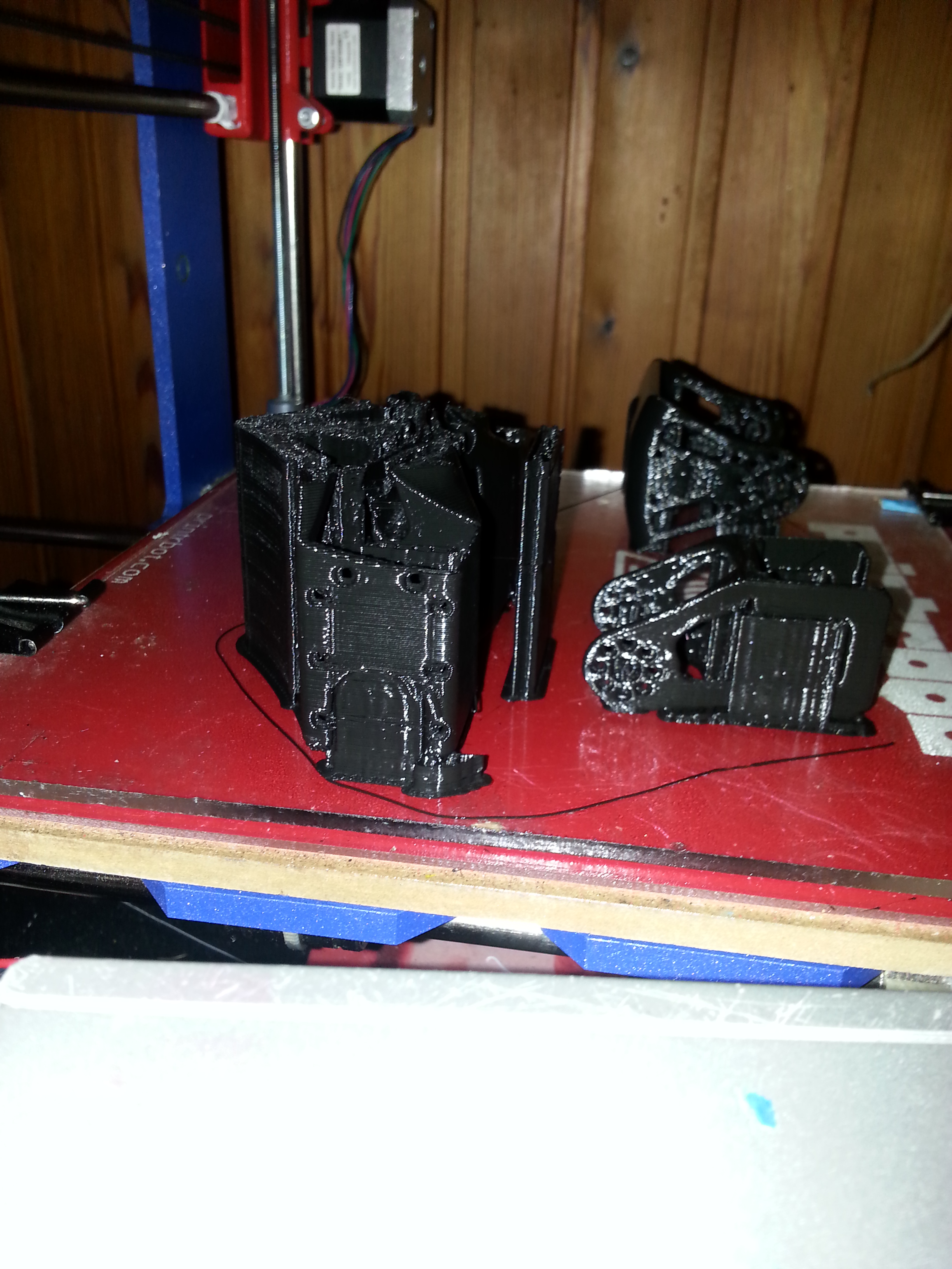

We’ve all experienced it at some point. Your prints just randomly stopping, your extruder getting clogged mid way, or anything else, the result is the same: when you come back to your printer all you see is half a print.
This happened to me this morning so I decided to make a quick post on how to make the best of the situation.
Step one
- Measure the height your print managed to achieve.
The height measured was 44.2mm, in this case I am using a layer height of .32mm with a first layer height of also .32mm.

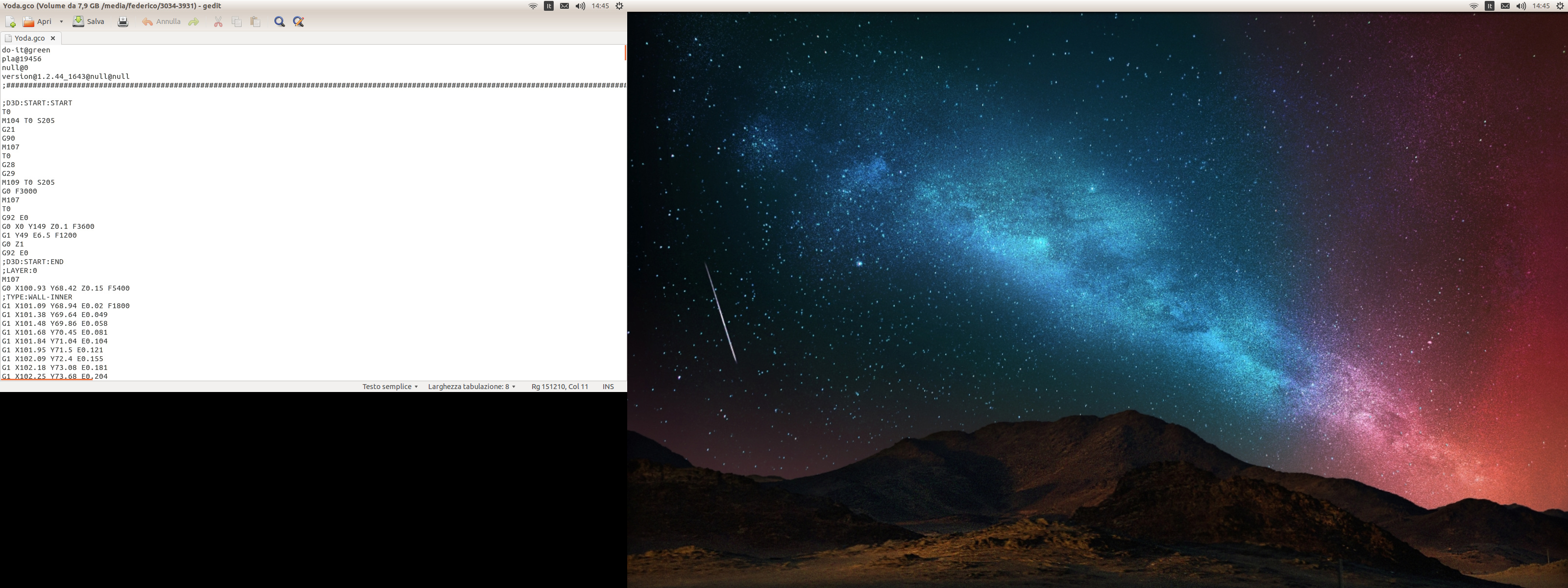

Edit your Gcode. In this case, I am using RepetierHost, but you may use any program to edit your code.
- Search for the line of code indicating the Z-value. Add a Z before the calculated height
In my case, I need to search for Z44.16
- click to select the end of the previous line of code
- Then scroll up and, while pressing shift, click on the end of your start Gcode (all the descriptive code)
- Delete the selection. You are now left with what you need to continue printing. Save it.
