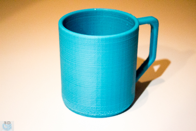

I have been playing around with different filaments for a while experimenting with the properties that each material offers. I feel like I have covered a good bit of the spectrum, I was wondering if anyone has any recommendations for any other filaments to play with?
I have printed a wallet in Ninja Flex and Taulman Nylon, a drone camera mount in HIPs and Proto-Pasta Carbon Fiber, a food safe Coffee mug, a Counter Strike Karambit in Proto-Pasta Stainless Steel, I have played with ColorFabb PETG+, a range of different woodfils, bronzefill, esun copper, water and lemonine disolvable filaments.
Is there anything I am missing?

What was the food safe filament you used? This is the one thing I think I have been missing from my list.
The are a few companies making FDA Approved filaments. Maker Geeks has one. I used a company in Atlanta who makes there own filaments.
