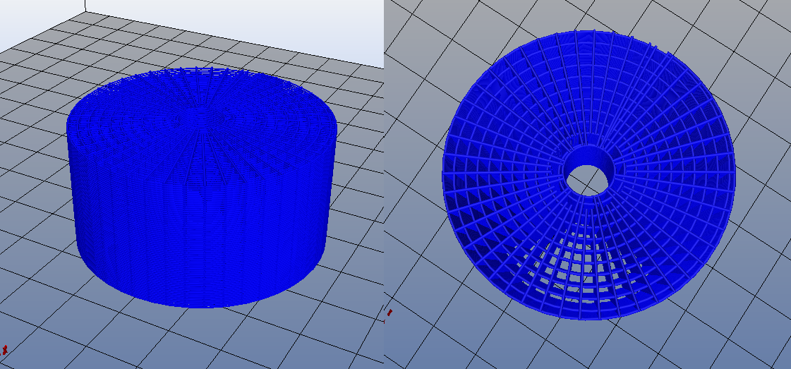

Will your files for the printed devices have this type of structure? Image is of the printed woodfill puck file used for the Oyster Mushroom experiment.

The models I have for printing are solid/do not have the kind of structure as the one in the oyster mushroom experiment. But I could change the structure so the mycellium would have a larger surface area to “eat”.

That experiment actually failed: after 3 days of expanding mycellium inside the “puck” growth stalled and withered.
As best I can tell the mycellium liked the wood filled PLA just fine, however the problem seems to be a lack of moisture. Specifically, wood-filled filaments don’t seem to wick moisture AT ALL, the plastic “casing” is too complete around the fibers.
I am trying again in a double-pronged experiment:
a) I am going to print a puck with greater density and smaller pores, so that perhaps the structure of the puck will wick moisture into the interior spaces “mechanically” via capillary action. I feel like this may be a tough line to walk between providing enough water and too much.
b) I’m preparing a culture of blue oysters on conventional rye spawn, and then i’ll insert a puck like the original one into the spawn bag. I’m hoping to see whether the mycellium will spread happily into the puck while having the benefit of the conventional spawn maintaining proper humidity. This is intended to confirm if woodfill is yummy to the fungus in the best conditions.
