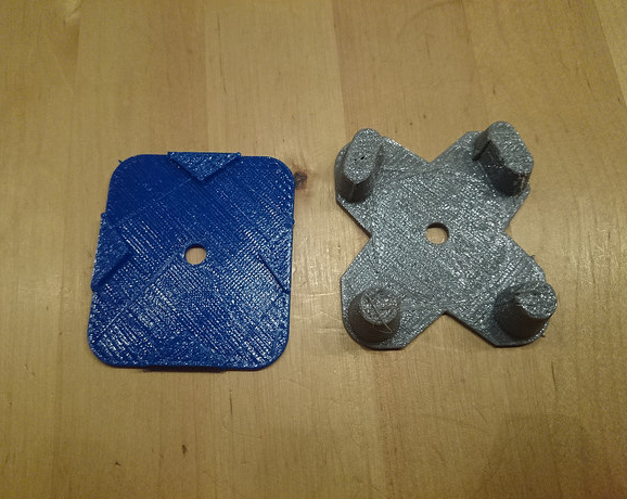

I ordered my first TPU print and I am fairly happy with the end result. But I would need the end result to be with even better quality. Might somebody know what is the best printer or best Hub to get the best quality by printing TPU?

Hi, Can you upload a picture of the print that you already have. Then I can evaluate, if I would archive better quality prints. -Marius
Hi, attached are the prints.
The blue design is printed with 85A and gray with 90A.
BR, Antti

Are there specific features, that this print has to have like solid infill and what is the size of this print ? I’d assume roughly 5cm in length but there is no reference in the picture.
-Marius
Yea to print with the better surface quality is exactly what I am looking for.
You assumed the size right it is about 5x5cm wide. There really is not any that specific features, but the print would need to be with more even surface.
