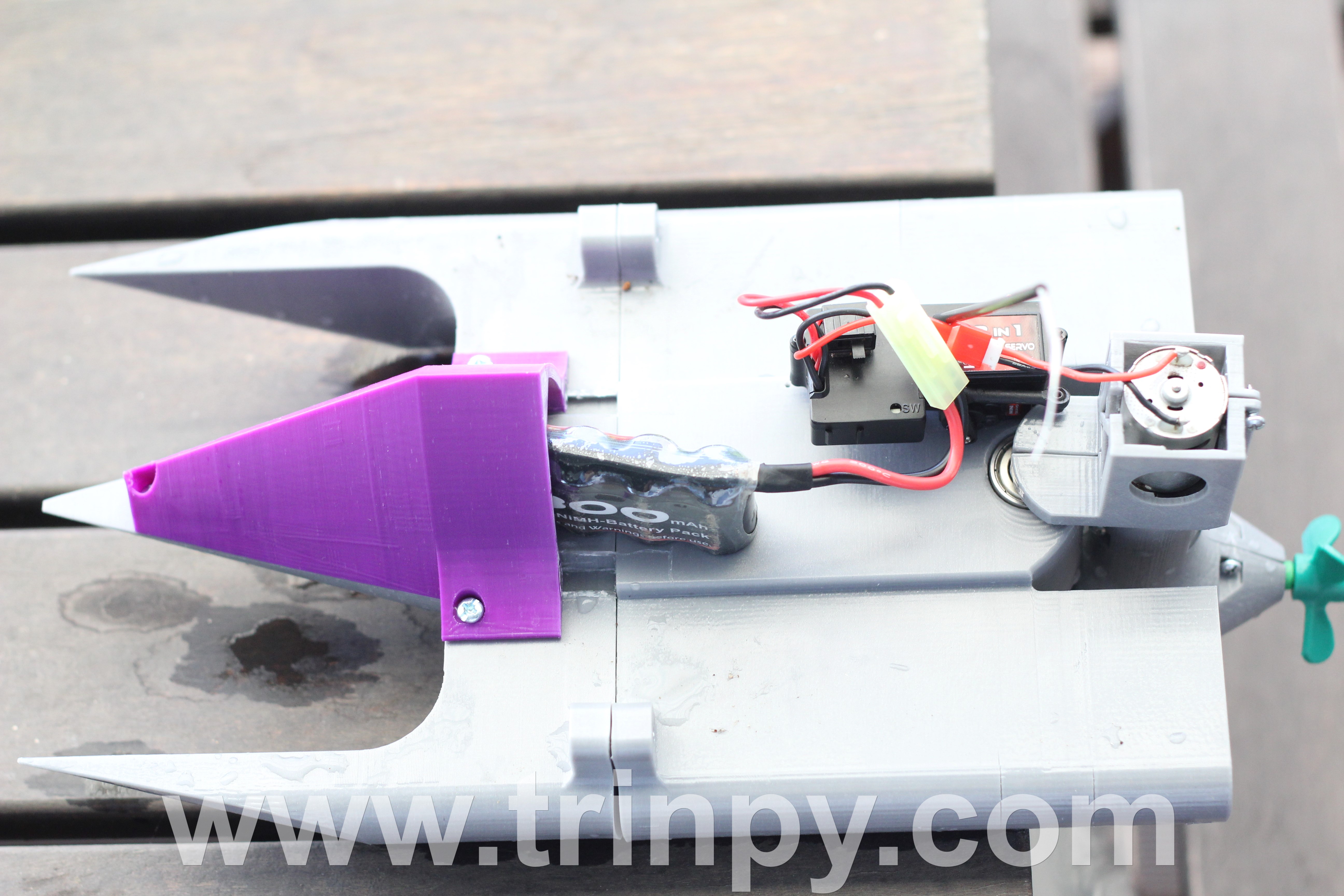

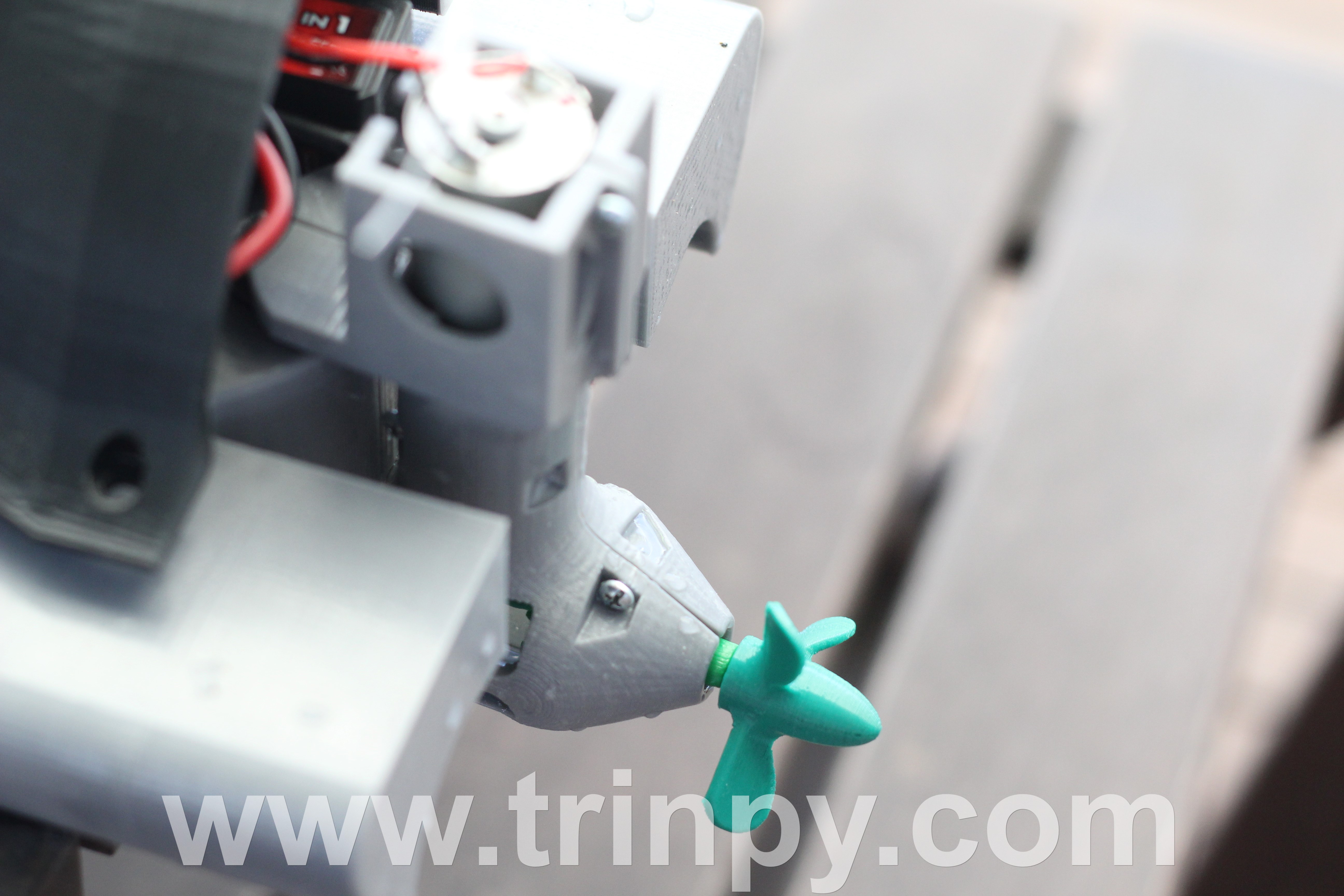

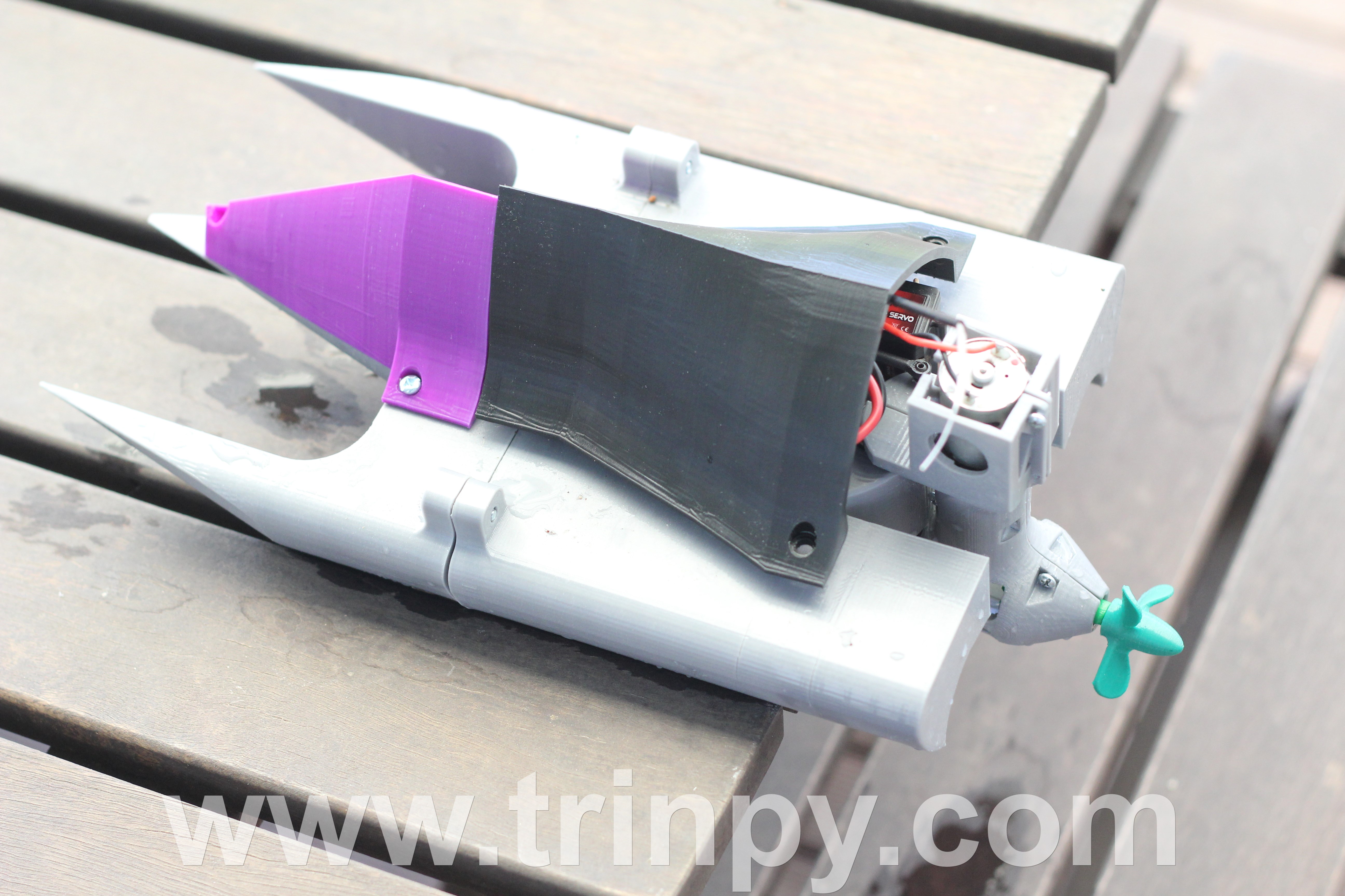

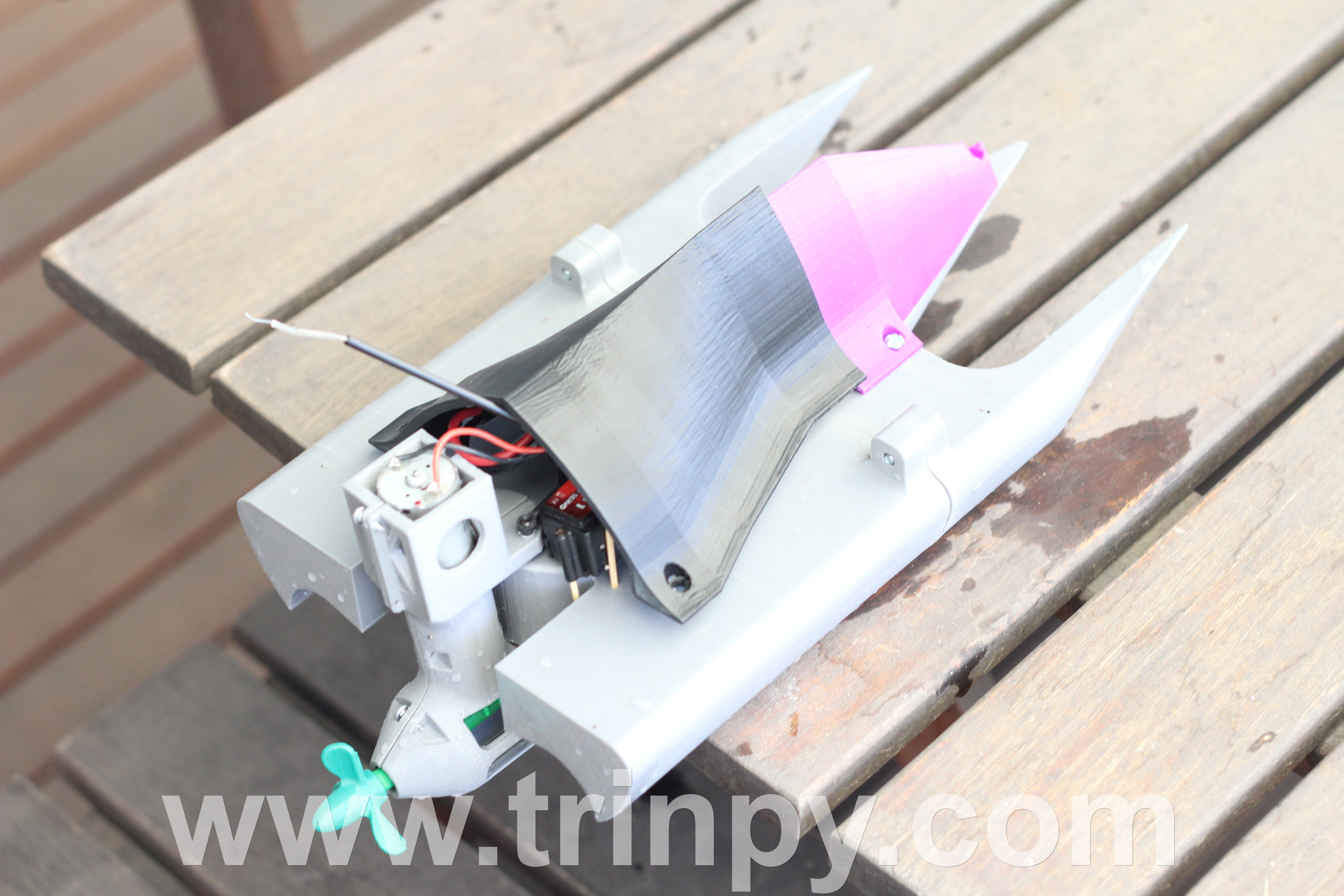

I have printed everything except the electric motor, bearings, battery pack and control system. The hull and top of the boat was all printed as was the outboard motor section (which includes propeller, gears, propshaft, driveshaft and the outboard casing). It was all printed in ABS and then sealed with acetone vapour smoothing to make it water proof. I attached the large sections together using buts and bolts that I melted into the print (I wrote a blog about the technique here). I printed the gears and shafts at 100% infill for extra strength while the rest was 10% infill.
