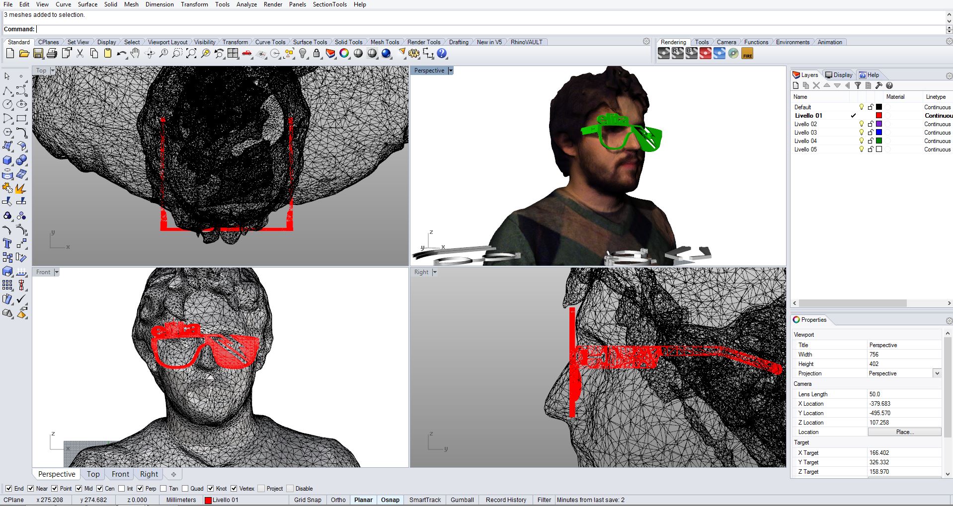

  • Before printing we’ll check that the glasses are fitting to their face using the 3D scan (this is really cool to see since the scan has also a texture and give realistic feedback of the print before it’s produced! see the attached image)
