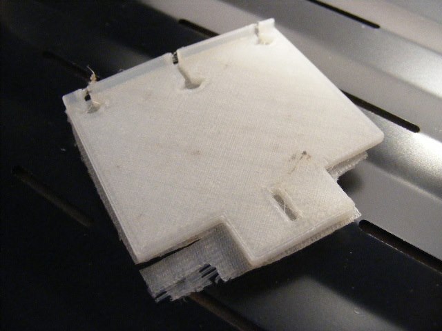

Printer with Taulman PCTPE goes very easy with this setting but I get not the raft off
Does anyone already have a solution for this?
Zortrax M200 - Z suite 1.10.0
ABS base materials configuration
Nozzle: 230°C
Bed: 70°C
Layer: 0.14mm
