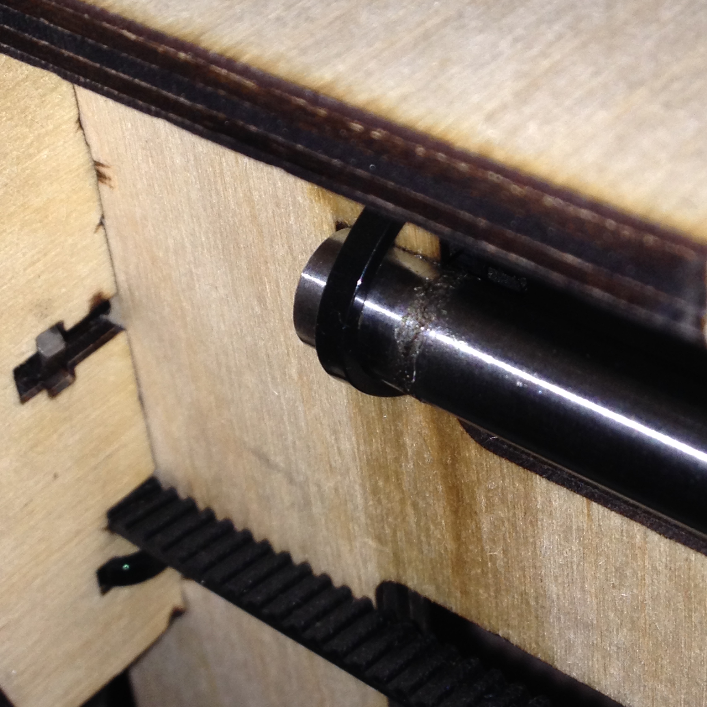

You can go to a local machine shop and request some “Side way Lube” is a high viscosity lube used on the bead of the mills. As previously comment the bearing are self-lubricant. Most important is to keep cover you printer when not in used, due dust in the room. See attached image, clean this accumulated dust with a cloth with some 3-1 oil but only clean the end of the shaft.
