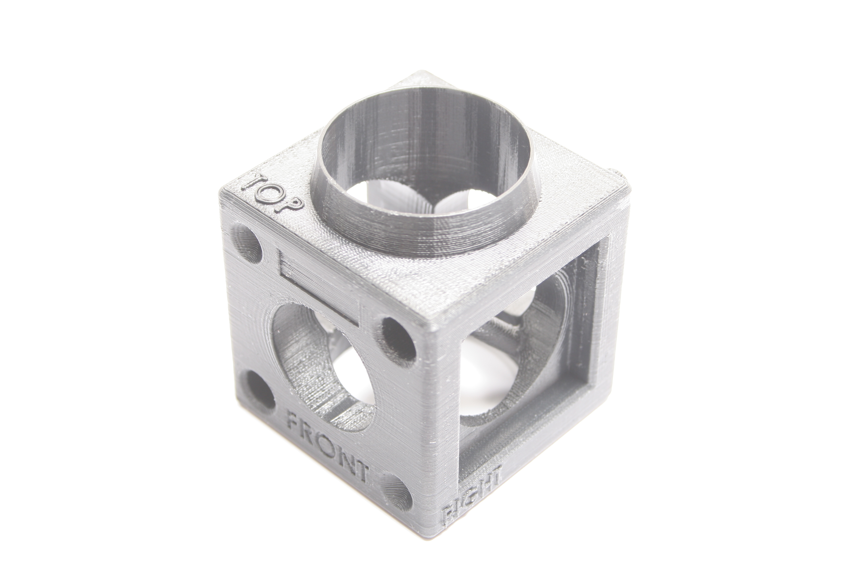

I’ve done a lot of research into 3D printers, mainly in the sub $4000 (USD) range to help support the engineering department I work in. I designed a test cube part and sent it out to many different 3D printer makers to print it in ABS, so I could compare it to a Dimension (12.4hrs, 0.17 layer). It’s a 2" cube with differing features on the outside, with cylindrical cuts thru it and a ball suspended in the middle by small support arms. It has a mix of male and female features that can be mated directly to any second part like puzzle pieces. It has a large flat bottom, equally tall vertical walls, small text features and a mix of conical/spherical/cylindrical/square features. Many refused to try it once they saw the difficulty, even though at first glance it looks very simple. A few companies wanted very high costs for samples, while some companies were nice enough to send the results for free. In the end, I got samples back from several companies.
Please keep in mind that some of the less-than-desirable results could have been due to the difficulty of the part, printing the part for free and not having enough time to troubleshoot problem areas. The list is of course not complete since some samples have not arrived or been ordered. Here are the results of samples and photos received up to this point:

Hi there! Would you mind publishing the .stl file so that I could do some test prints of this on my leapfrog creatr HS? So far a really good test, pictures would be perfect for me visual comparison from our (our = community) own perspective. -Marius
Here are a few pictures. These are from my Dimension sample.
Wow these are detailed prints, thanks for sharing!
