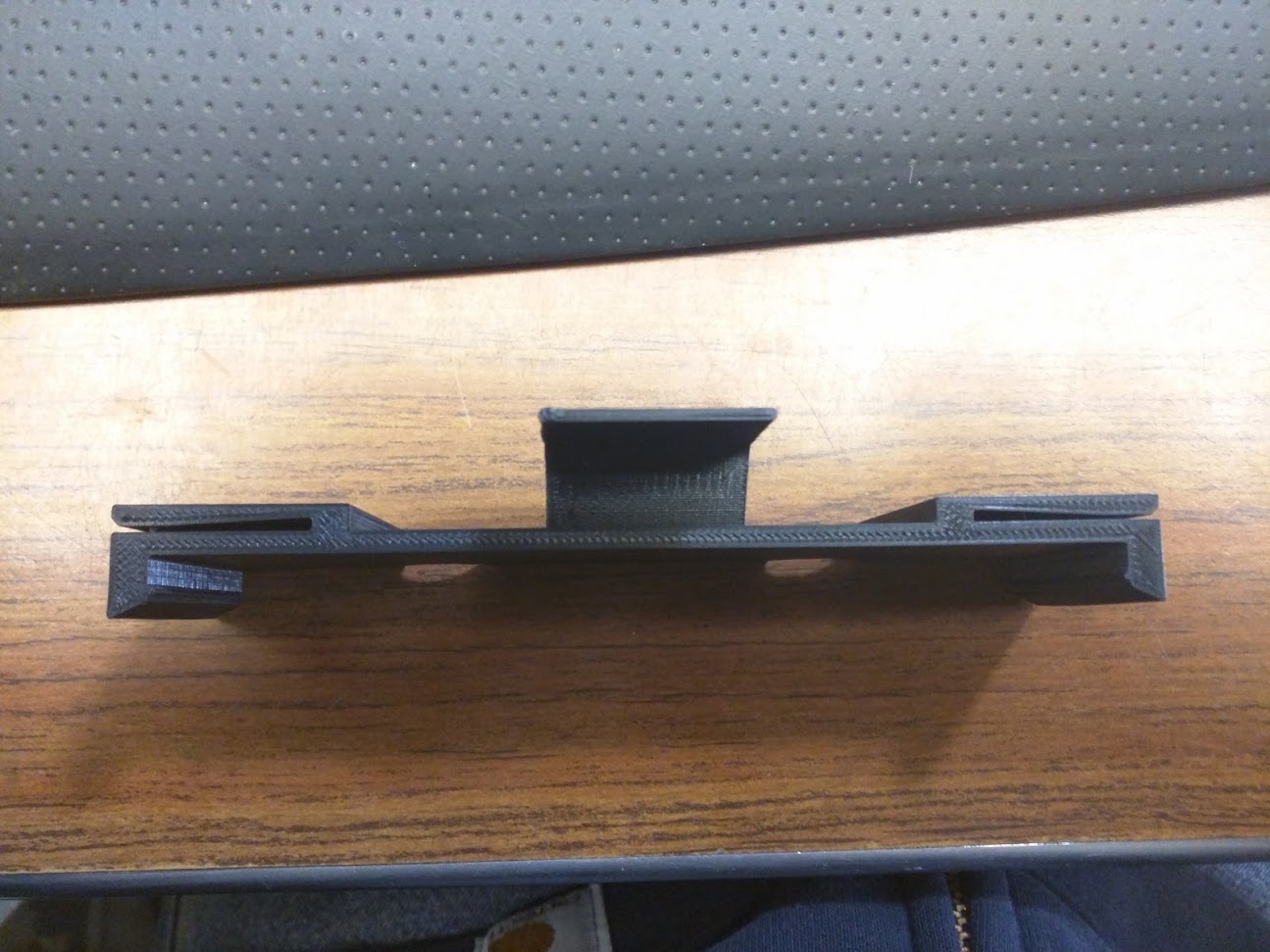

We actually build and repair injection molds at our shop and this particular part is out of our league. I am not saying it’s impossible but it would be a very expensive mold for only 10k parts.
Here is a better look at the part that shows why it would be difficult to mold.
I am starting to think we’ll just hammer by purchasing several more FDM style printers.
Thanks again for all the input.
I wanted to think a polyjet would work because they can do some really cool stuff, but I don’t think its the right fit for this job.
Brandon
