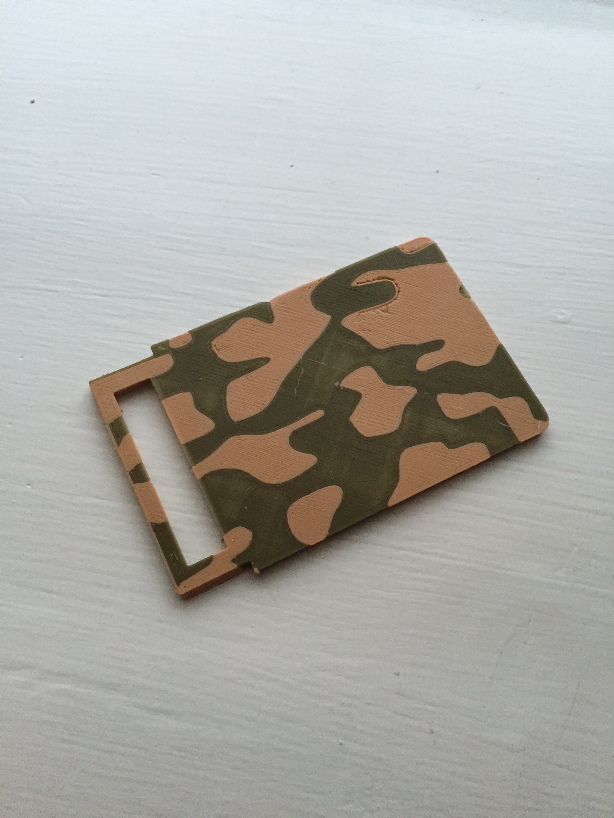

Here is a picture of what I’m working on. I designed it from scratch on Tinkercad.
Thanks! Jason

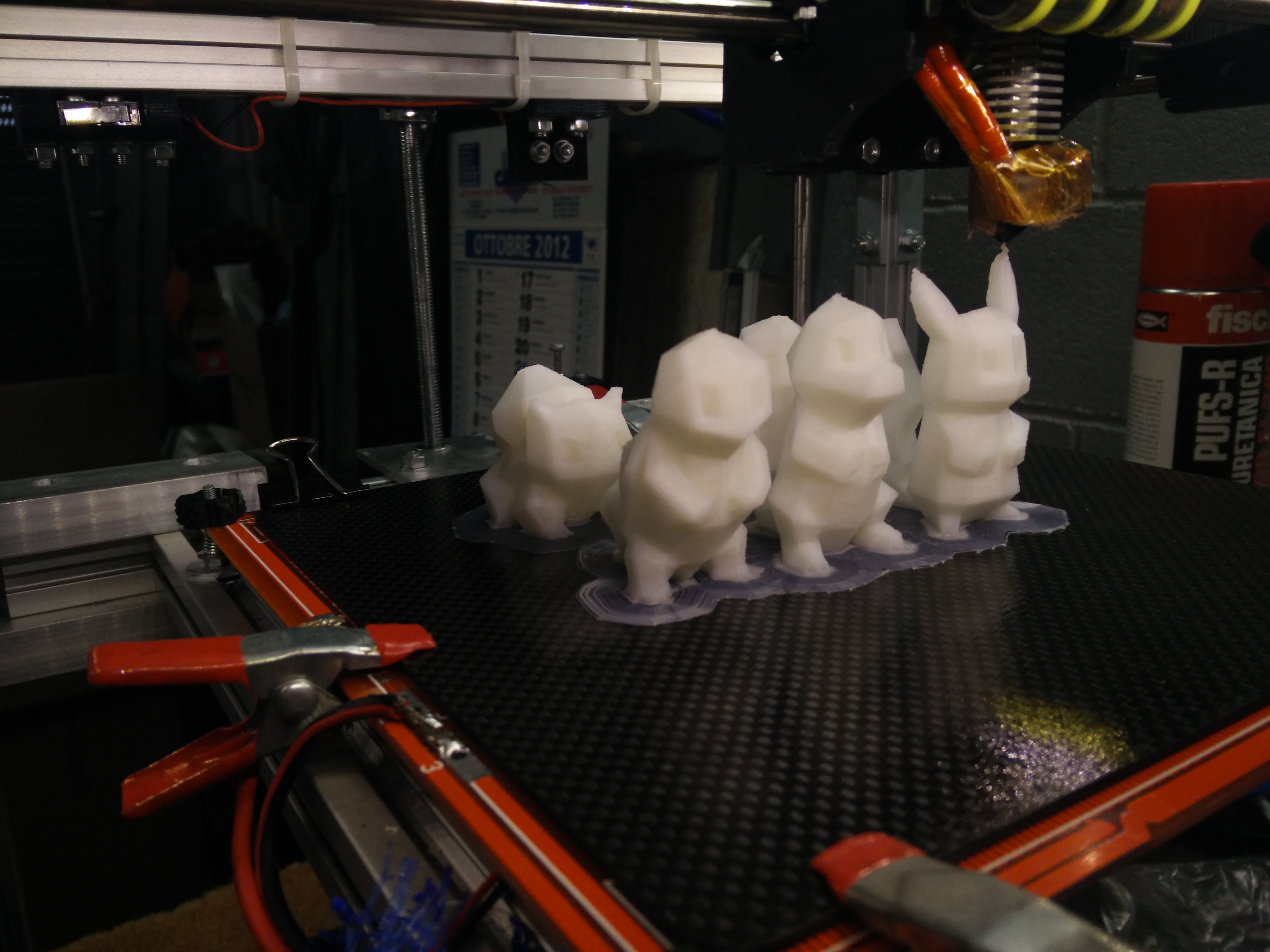

The filament change it’s property after The extrusion or sill remain The same? Is useful to use The oil Also with HIPS and ABS? And man, great job with the low-poly Pokémon, I given to my best friend at his birthday and he was really happy!

Nice Pokemon there! :wink:
