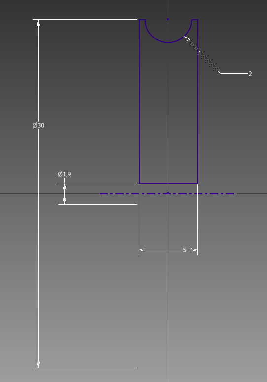

could someone please create a small pulley for a motor? 30mm diameter 5mm thick disk with a radius around it 2mm deep. 1.95mm diameter hole in the center. the reason i need this is because i am making a robot in school but i can’t make the piece in autodesk, i keep getting errors and it keeps deleting itself when i try to add the center hole. just attach the file to a comment if you can.

you’re already uses Autodesk. For this piece it can’t be difficult, try to use the command " revolve". that will do all what you need to draw this piece.
You need to draw a sketch with a centerline and revolve your sketch around the centerline.
