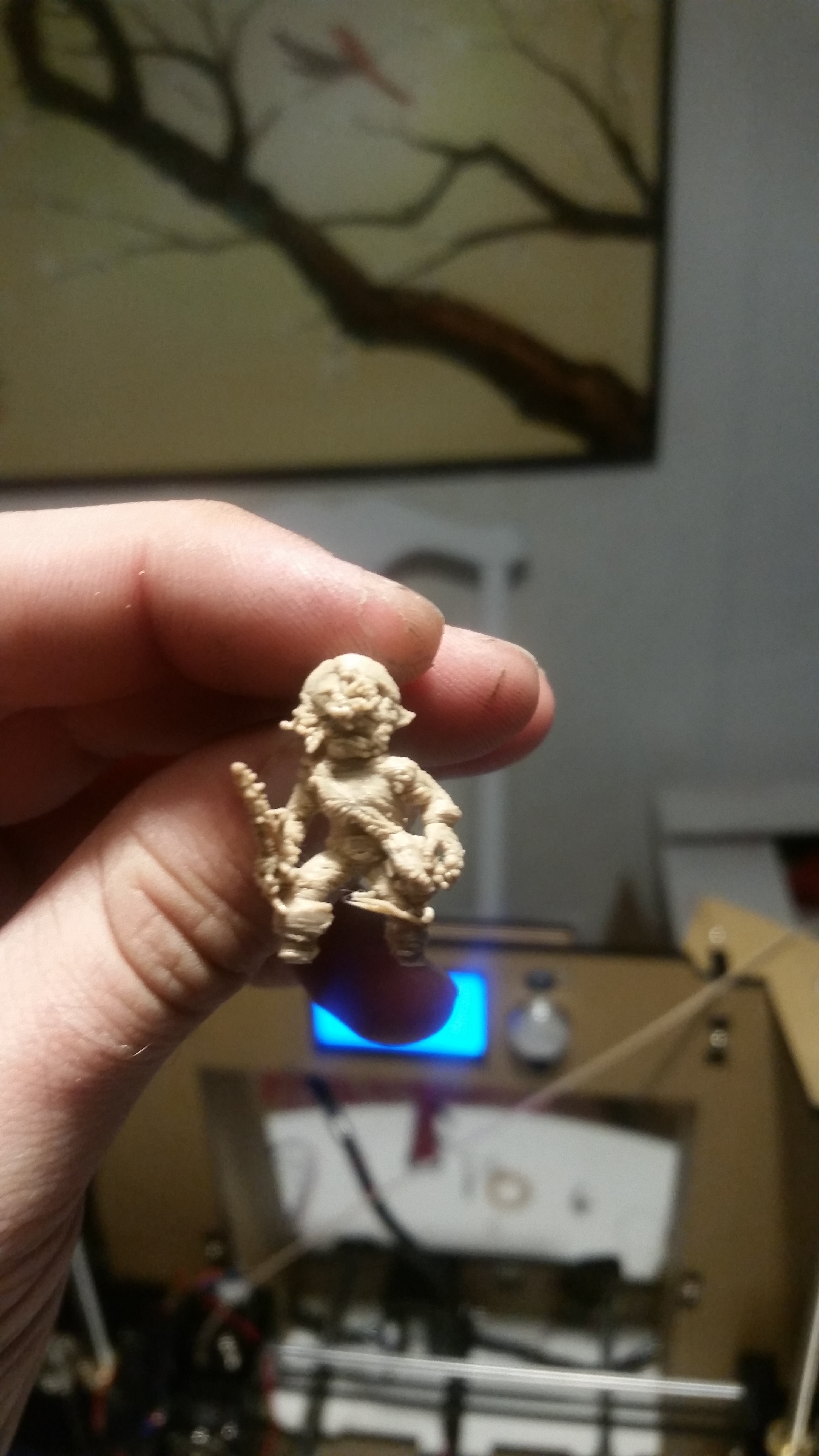

Currently, I’m trying to do a D&D miniature for my fiance. I have scaled this up 22% in an attempt to get it to come out with a bit more detail (plus our board is much larger and we’d lose it). I’m attempting a print currently with 40mm/s, 20% infill, 2mm layer height, 100% flow, 200 C, 100% FR, walls are at .8, and i always have the fan enabled. I am unable to take an image of what WAS happening, but basically once it got above the knees, the nozzle would pretty much take the piece with it, creating a stringy mess. The bed is pretty darn level (did the paper test on all corners and the middle). I did have 2 prints of this come to completion however, they had very poor detail. After I get this done, I’m going to attempt to get a mask from the movie Predator completed.

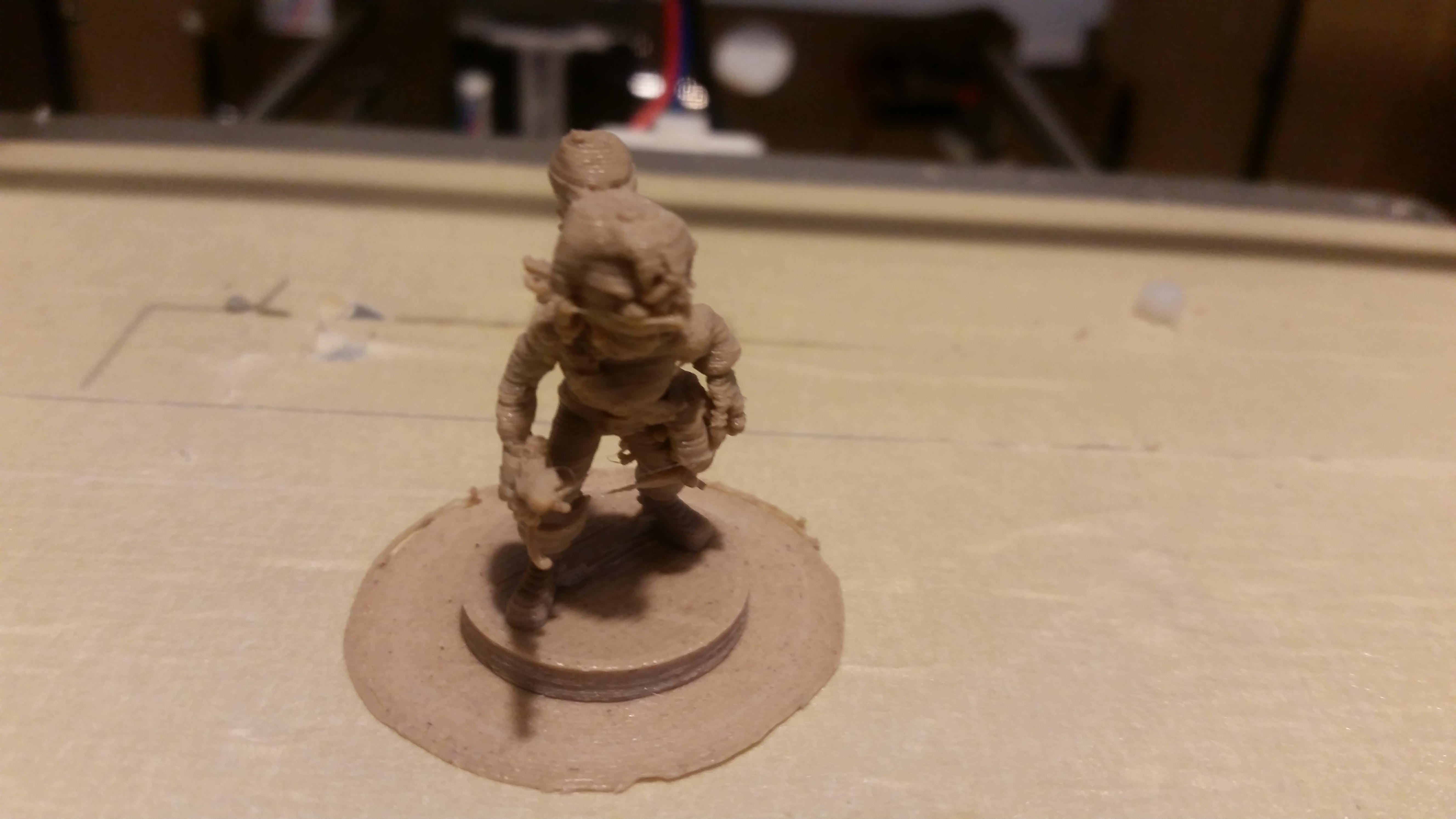

This was at those settings
The STL is in a previous reply along with an image. This is what happened when I went to a layer height of .15

it seems like u didn’t use support ?!?!
Did u set the temperature to the filament manufacturer setting?
If your filament is ABS then 200 is too low
What is the material? Looks like a bit fast and hot. One way to do small parts is to print 2-4 at a time or make a sacrificial print tower. Just some way of getting it to let the part sit a minute between layers.
